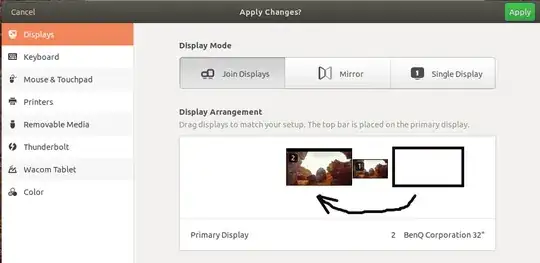

Open Settings > Devices > Displays and use your mouse to move the second monitor where you want it:
Finally click the green Apply on the top right edge of the window. If the two displays are of different sizes, you can also align the smaller display to the middle (as I have) or with the top or the bottom of the bigger display. If everything looks okay, click on "Keep Change" or else "Revert Settings" as prompted.
Once you move the second monitor to the left of the first monitor as shown above, you may want to move the The dock and the top bar to the left most screen as well. You can do this by making the screen 2 the primary display, as shown in the figure above.
If you want the dock to appear on both the screens go to appearances tab on the left panel of the settings window and change it there as shown in the answer by Dan Dascalescu.
