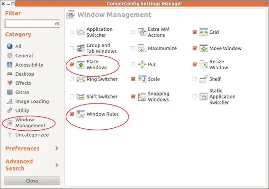

Open ccsm. You'll be using the Place Windows and Windows Rules plugins in the Window Management section.
Compiz Window Managment

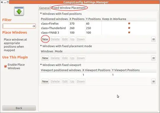

First, go into Place Windows, select the Fixed Window Placement tab and Select New.
Fixed Window Placement screen

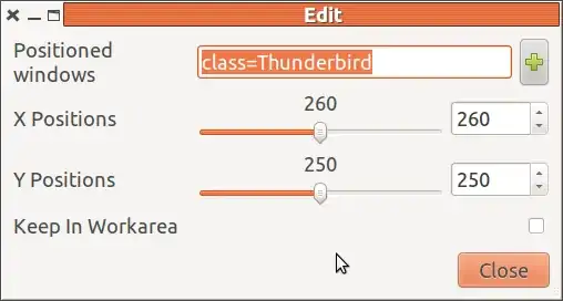

Enter the program name (class=xxxx) and set the starting X and Y coordinates. The coordinates start from the top left corner of the screen. This tells the program where to open on the screen.
Enter placement rules

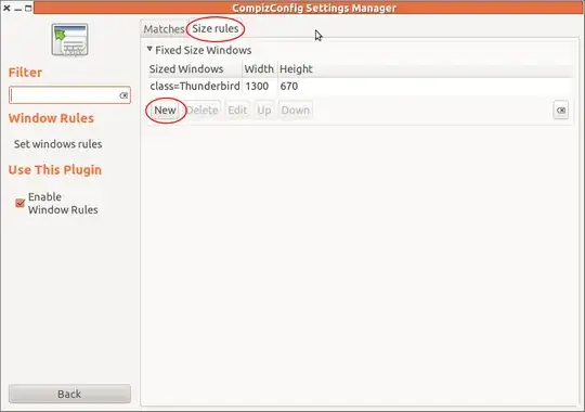

Next go to the Windows Rules plugin and select the Size Rules tab and new.
Window Rules screen

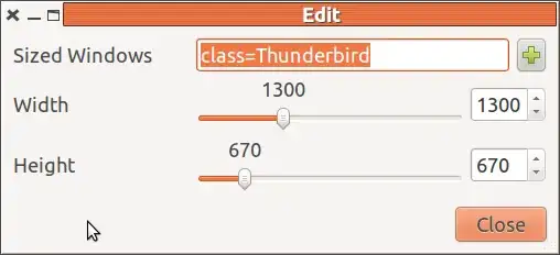

Enter the program name (class=xxxx) and set the X and Y size. This tells the program what size to open the program in pixels (pixels wide x pixels high).
Enter size rules

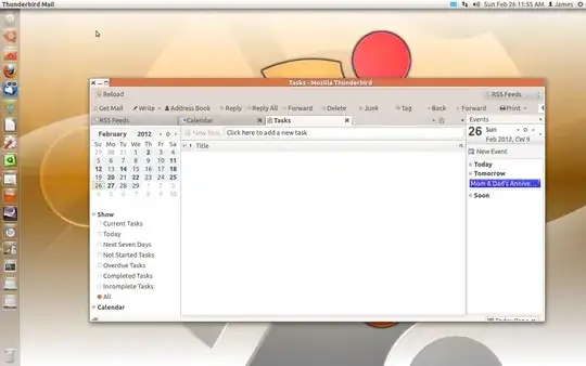

Now, open the program you just did this for and it should open where and how big you want it to everytime. Open your program
