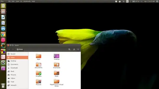

Whenever I use my shortcut to open the home folder it's always positioned at the bottom left of my screen as shown below.
Bottom left

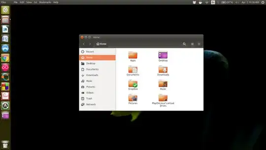

How can I open it in such a way that it would pop up in the center like this?
Center

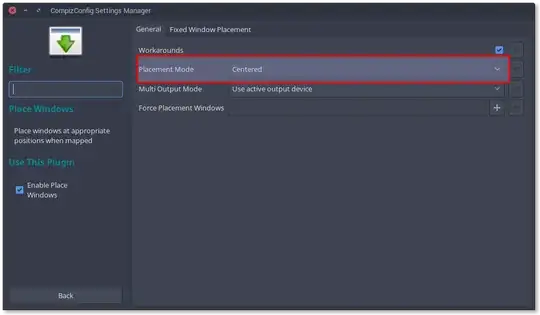

Window placement is handled by compiz in Unity and to fine control it's behaviour, you need to install ccsm or compizconfig-settings-manager.
Install it with this command
sudo apt-get install compizconfig-settings-manager
Open it and go to Place windows plugin page. Under the section Placement mode select Centered to have the desired effect.
The default selection is smart I think. You can also try Cascade which is the default case in Windows systems afaik.
window placement settings image
