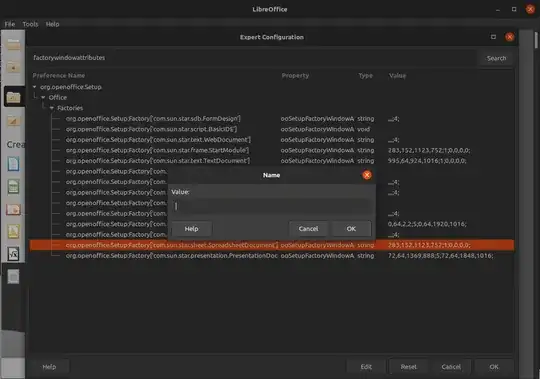

Default window position and size for Calc, Writer and other modules are stored in LibreOffice configuration. You can reset the defaults from the Expert Configuration window.
To open it, go to menu Tools > Options > LibreOffice > Advanced > Open Expert Configuration, then search for FactoryWindowAttributes (search is not case sensitive).
This will list several items, one for each LibreOffice module, such as Writer (TextDocument) and Calc (SpreadsheetDocument). Names are self explanatory.
Double click on the one related to Calc, and reset it, deleting the current value, and click OK. Then click OK on the other configuration windows to save your preferences.
Expert configuration window screenshot

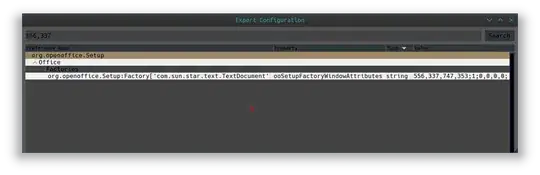

LibreOffice stores information about window size and placement in ~/.config/libreoffice/4/user/registrymodifications.xcu which is an xml file.
The registrymodifications.xcu file is not meant to be accessed by the average user. However, if you go into Tools > Options > Advanced, you'll see a button labelled Open Expert Configuration. Clicking this button opens a window containing the contents of registrymodifications.xcu and maybe other stuff as well. You can identify the line storing your last used window size and position if you know what to look for.
Because I'm not an expert, I took another route. I used xwininfo to check a LibreOffice Writer window:
  Absolute upper-left X:  556
  Absolute upper-left Y:  337
  Relative upper-left X:  0
  Relative upper-left Y:  0
  Width: 747
  Height: 353
  Depth: 24
  Visual: 0x10e
  Visual Class: TrueColor
  Border width: 0
  Class: InputOutput
  Colormap: 0x5400002 (not installed)
  Bit Gravity State: NorthWestGravity
  Window Gravity State: NorthWestGravity
  Backing Store State: NotUseful
  Save Under State: no
  Map State: IsViewable
  Override Redirect State: no
  Corners:  +556+337  -63+337  -63-78  +556-78
  -geometry 747x353-63-78
Then, I opened a copy of ~/.config/libreoffice/4/user/registrymodifications.xcu and searched for lines containing 747 (based on the -geometry). That got me just the one line:
<item oor:path="/org.openoffice.Setup/Office/Factories/org.openoffice.Setup:Factory['com.sun.star.text.TextDocument']"><prop oor:name="ooSetupFactoryWindowAttributes" oor:op="fuse"><value>556,337,747,353;1;0,0,0,0;</value></prop></item>
Now, I knew what to search for in the Expert Configuration window I mentioned earlier. That window has a Help button offering some documentation in case you want to look deeper into matters.
