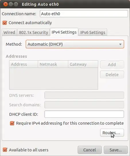

If you're using NetworkManager, it should just work. That said, you will need to set specific settings for your wired connection.
Select your wired connection in the Connection Editor window for NetworkManager (right click on the applet icon, then select Edit Connections). Click Edit, then switch to the IPv4 Settings tab and click the Routes button at the bottom.

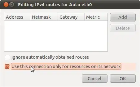

You can then force the wired connection to not claim the default gateway (since NM would usually prefer wired over wireless), by checking the "Use this connection only for the resources on its network" checkbox.
