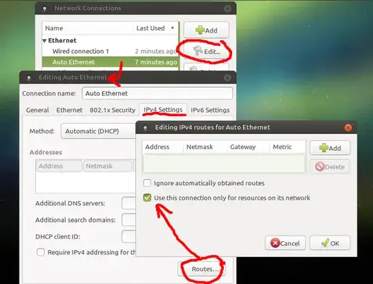

I would like to have access to both of these networks simultaneously. As per the posting above, I have set up the wired, local-only, Ethernet connection ("Auto Ethernet") thusly:
... so this connection should not try to go on the internet. However, it doesn't work.

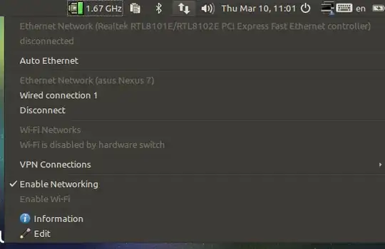

When the wired, local-only, Ethernet connection ("Auto Ethernet") is disconnected from Network Manager:
So I have this:

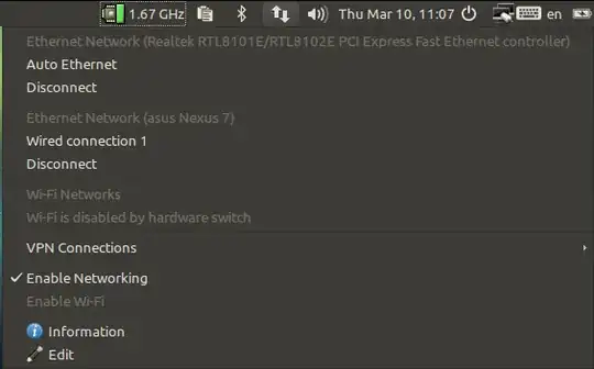

However, if I now turn on the wired, local-only, Ethernet connection ("Auto Ethernet"), so it is connected at the same time as the USB Internet connection:
..., then I have this:
