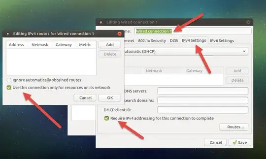

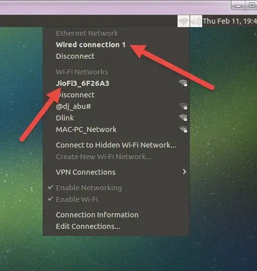

I am setting up networking on my ODROID C1 running Ubuntu 16.04.1 LTS (GNU/Linux 3.10.104-181 armv7l) . Internet access over WiFi works fine but when I plug-in the ethernet cable (which has no internet) the internet stops working. I tried solution provided here - How to set up dual wired and wireless connections? and route add default dev wlxe84e060e7296 metric 20 as provided here - Make wifi preferable over wired connection in Ubuntu 14.04? without any success.
Relevant Network Manager screens:
Network connections
Use this connection only for the resources on its network

Managed to fix this, updated DNS to wifi adapter via Network Manager and it worked
