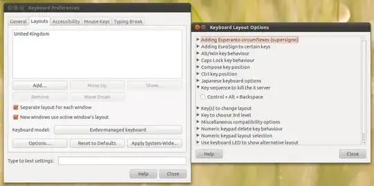

For Unity (13.04 to 17.04):
You want: System->Preferences->Keyboard
Then click the Layouts tab, the Options button, and expand Key sequence to kill the X server, before finally selecting the checkbox.
Screenshot

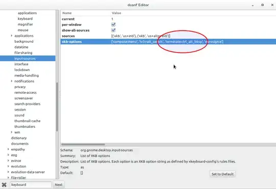

You can also use dconf-editor. This option will make the setting persistent across sessions.
sudo apt-get install dconf-editor
After starting the dconf-editor, navigate to org >> gnome >> desktop >> input-sources
Add the options that you need in xkb-options. The option strings are surrounded by single quotes and separated by commas. Be careful not to delete the brackets on the ends.
To enable ctrl+alt+backspace to kill the X-session, add 'terminate:ctrl_alt_bksp'
You can use this method to enter most of the traditional xkb options that are no longer available in System Settings >> Text Entry. The exceptions are the settings for switching the keyboard layouts, which currently do not work because of a bug.

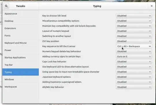

(This is for Gnome Ubuntu, but I suppose it is the same for Unity --- please someone confirm this).
You should install gnome-tweak-tool (if not installed already) and run it. You will find the option you are looking for under "Typing":
g-t-t typing
If you feel more confortable with dconf-editor (or you do not want to install gnome-tweak-tool), you can open dconf-editor, navigate to org.gnome.desktop.input-sources, and then add the word "terminate:ctrl_alt_bksp" to the xkb-options property.
dconf-editor xkb properties
Note that the other properties in the list will be probably different for your keyboard.

For Ubuntu 20.04 with Gnome 3 desktop, with the Gnome Tweaks app:
  1. Open Gnome Tweaks
  2. Navigate to Keyboard & Mouse tab
  3. Find and click the button: Additional layout options
  4. In the list popping up, locate and expand the item labelled Key sequence to kill the X server
  5. Check the checkbox for the desired key combination
    • probably it's gonna be Ctrl+Alt++Backspace
