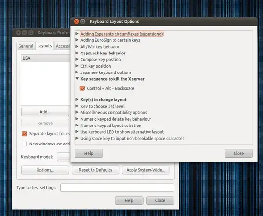

You can also do this just for your user. System -> Preferences -> Keyboard go to the Layouts tab and select Options. Then check Key sequence to kill X server.
alt text
Or run gnome-control-center from a terminal if you're using a shell without that same menu hierarchy.
