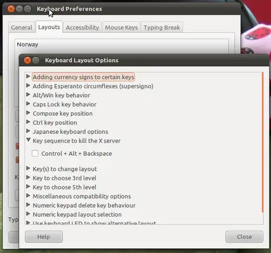

Gnome:
Open the keyboard preferences (Search for keyboard in Dash), go to the Layout tab and press Options. Open Key sequece to kill the X server and toggle Control + Alt + Backspace
