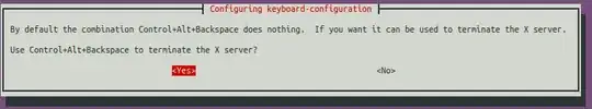

Especially the answer "13.10+, type the following on the terminal: dpkg-reconfigure keyboard-configuration" seems relevant.
(That should trigger this screen:) enter image description here
