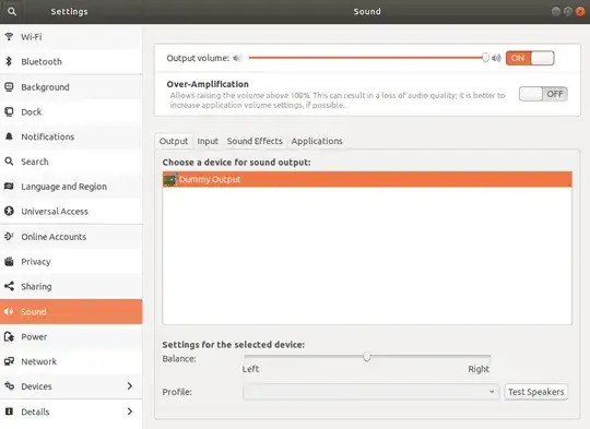

Dummy output is showing in Settings -> Sound in Ubuntu 18.04.
enter image description here Dummy Output
I tried:
sudo alsa force-reload
It does nothing. I am not sure what else to try.

Dummy Output
I realize this is an older question but following the suggested fixes did not work for me. I was running 16.04 just fine but did a fresh install of 18.04 and lost audio. I further upgraded to 18.10 and still did not have audio.
Profile
After a bit of searching, I found help on this forum. When running pacmd list-cards I noticed that although it saw my audio card, the active profile was off. To fix this, I ran:
pacmd set-card-profile alsa_card.pci-0000_00_1b.0 output:analog-stereo+input:analog-stereo
As soon as I did this, my Sound Preferences showed Built-in Audio Analog Stereo under the output tab instead of Dummy Output.
