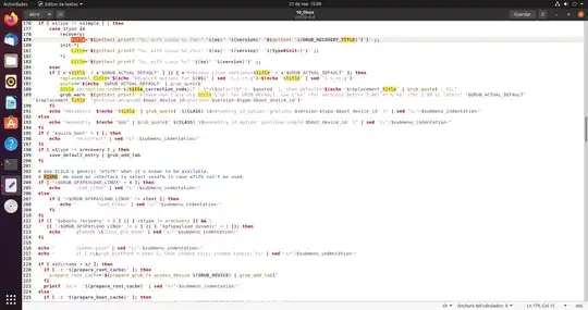

I´m trying to edit the description of the operating system I have installed by executing the terminal with the comand sudo gedit /etc/grub.d/10_linux. Then I know I need to change this bit of code I show on the screenshot, but I have been trying changing everything and nothing seems to work, what am I doing wrong?

Screenshot of the config file from sudo gedit /etc/grub.d/10_linux.
Whenever you edit files in /etc/grub.d, you need to run
sudo update-grub
to create a new configuration file (/boot/grub/grub.cfg) and thus apply the changes you made with your edit.
