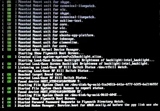

I recently upgraded my laptop from Ubuntu 17.04 to 18.04. It worked perfectly well and I have been using it without any problem, but yesterday I issued sudo apt upgrade and it upgraded some packages. Then I restarted the PC and it didn't boot up again. After displaying the Ubuntu logo I get a screen like below and after flashing several times it freezes.
Note that the message on the bottom line is changing for each restart. I am able to start a tty session there log into my account.
normal boot messages usually covered by splash screen enter image description here To my knowledge, the problem is gdm3 (GNOME display manager) fails to start, since when I issue sudo systemctl restart gdm3 the screen flashes several times and again stays in tty session.
