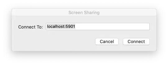

I create an ssh tunnel on macOS like so:
gcloud compute --project "annotator-1286" ssh --zone "us-central1-a" "ubuntu@yocto" -- -NL 5901:localhost:5901
and then I can connect with the "Screen Sharing.app" by pointing to localhost:5901.
