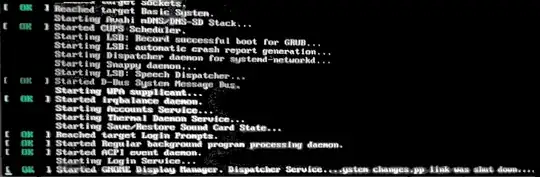

Currently, after the Ubuntu logo splash loading screen, the screen (filled with text) starts to flicker at regular intervals, showing these messages on screen with no change (it took like 5 minutes to take these photos because they only flicker on for a short time, then they disappear for a couple seconds, then reappear again - etc).
In recovery mode menu I tried option to "repair broken packages" - it seemingly succeeded but it didn't help at all, now different messages flicker with no change in behavior.
Here are the images: https://i.sstatic.net/auQKx.jpg 1-3 are the images at first, II1 - II3 are after Repair Packages attempt. If they're identical (I think they might be but I'm not sure) then I guess you have two versions of the images?
Using recovery mode simply nets "out of range/60khz" error on my display, and nomodeset does nothing, it still results in flickering text. Yesterday (last time I used Ubuntu) everything was OK.

EDIT: Full text of the final line of text:
Started GNOME Display Manager. Dispatcher Service... system changes.pp link was shut down....
