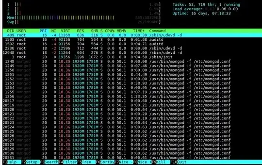

Let's try something more:
sudo apt-get install htop
The top command is the traditional way to view your system’s resource usage and see the processes that are taking up the most system resources. Top displays a list of processes, with the ones using the most CPU at the top.
htop displays the same information with an easier-to-understand layout. It also lets you select processes with the arrow keys and perform actions, such as killing them or changing their priority, with the F keys.
htop screenshot
