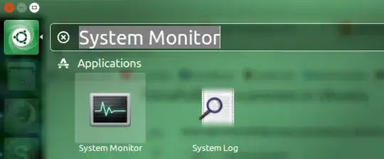

Launch the System Monitor by searching for it in the Unity dashboard:
Unity search System Monitor results

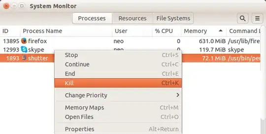

Right-click on the process you wish to kill and select Kill from the right-click menu:
Kill Process menu

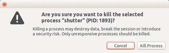

Then click Kill on the confirmation dialog that pops up:
Confirm Kill process Dialog
Although it might be more advisable to select End from the right-click pull-down menu, but it really depends on how unresponsive the process is.
