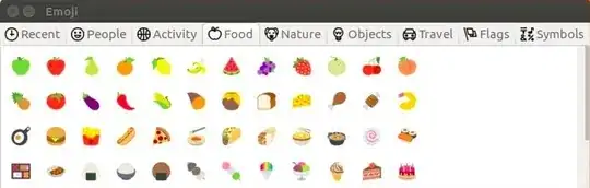

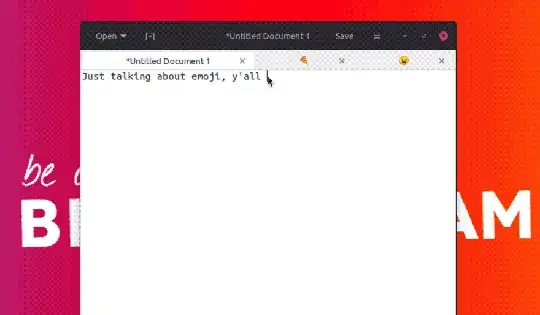

  1. Emoji Picker: With the release of Ubuntu 18.04 LTS you can use emoji on Ubuntu right out of the box (for native GTK Linux apps like Evolution, Text editor, Gedit, Corebird, Rhythmbox and probably Geary (Source: OMG Ubuntu):
    Right-click (or Control-. ) in a text-field and select the “Insert Emoji” option from the context menu. enter image description here This picker pop-over lets you:
    • Browse emoji by category
    • Pick from recently used emoji
    • Search for emoji by name
    • Click on an emoji to enter it
      The emoji picker even works on other Linux distros & desktops besides Ubuntu, including Ubuntu MATE and Ubuntu Budgie.

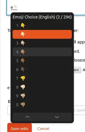

  • Press Ctrl + . (or Meta + .), and a will appear, then press Space to see the Emoji Choice popup where you can select your unicode character from categories or ...
  • Press Ctrl + . (or Meta + .), and a will appear and the type a word followed by space to search for an emoji, then press Enter to choose the selected emoji OR space again to see other choices in the popup.
    (Thank you Madacol for the update, please upvote his answer, too.)

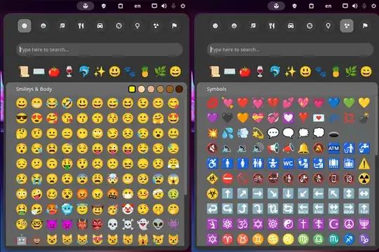

  2. GNOME Shell Extension Emoji Copy for non-GTK apps like Firefox, Wire Messenger, Chromium, or LibreOffice: enter image description here It is a fork of GNOME Shell Extension Emoji Selector which works up to GNOME 43. Thank you, Didier L, for the tip!

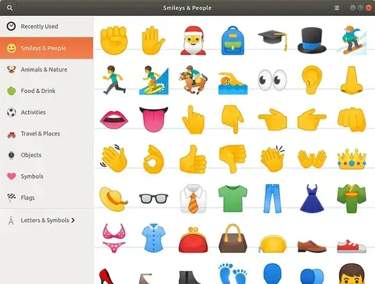

  3. GNOME Characters app: Another option to install to easily browse emoji.
    Optionally, you can enable emoji search in the Activities Overview by using the Settings app. Just open Settings > Search and turn on Characters.enter image description here

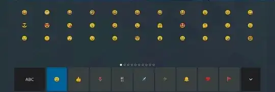

  7. Emoji input to the on-screen keyboard (Ubuntu 19.04+, GNOME 3.32: it should make it easier to reply with a well-timed emote from a touchscreen device. enter image description here

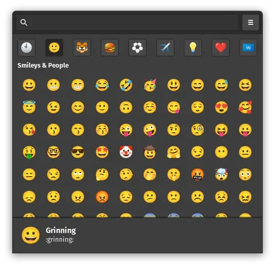

  8. Emote was mentioned by James, please vote the answer below up, too. The emoji picker can be opened with either the keyboard shortcut (choosing one or several emojis) or by clicking the app icon again. More details on the Github page.
    Install the snap app from the Software Center or Snap Store on or in a terminal:
    sudo snap install emote enter image description here

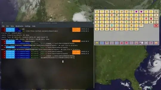

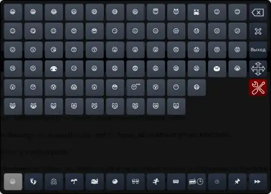

  9. Emoji OnBoard keyboard layout was mentioned by Tanius, please vote the answer below up, too. It is an emoji chooser layout for the default Ubuntu onscreen keyboard "Onboard". strong textIt works for all applications. Instructions for how to us on the github. enter image description here

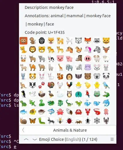

Use the following keyboard shortcuts:
  1. Hit Control-Shift-E, then press Space.
  2. You should see the Emoji Choice popup where you can select your unicode character.
    Note: To cancel the selection, press Escape few times.
Emoji Choice on GNOME Terminal, Animals & Nature, Unicode special characters
Tested on Ubuntu Cosmic (18.10). It should work in editors, terminal, web browsers and other applications.

Emote is a modern, system-wide emoji picker which is a decent option in 2021.
https://github.com/tom-james-watson/emote
It should work on all major desktop environments and supports both X11 and Wayland.
emote app window
Installation:
Get it from the Snap Store

  1. Press Ctrl + . (or Meta + .), and a will appear.
  2. Type a word to search for the emoji.
  3. Press space to preview the closest match.
  4. Press Enter to accept, or space again to see other matches (a popup should appear as the image below ).

You can use the Emoji OnBoard keyboard layout. It is an emoji chooser layout for the default Ubuntu onscreen keyboard "Onboard":
Unlike many other solutions, it works together with all applications. While for example emoji-keyboard can only insert the emoji characters directly into Gtk applications and otherwise is restricted to copying them into the clipboard. So there is definitely a way to do software keyboards right under Linux, and I wonder why it's not more widespread ...

I will just add additional information to @Filbuntu 's answer on how to add GNOME Shell Extensions Emoji Selector to Ubuntu Firefox based on my experience.
First you will need to open add ons menu, and add this extension: GNOME Shell integration Gnome Shell Integration Screenshot image
After that, you can go to this page https://extensions.gnome.org/extension/1162/emoji-selector/
If there is an error message like "native host connector is not detected", then you need to install chrome-gnome-shell using the following step based on this answers
sudo apt-get update
sudo apt-get upgrade
sudo apt-get install chrome-gnome-shell
After chrome-gnome-shell, you can refresh the gnome shell extensions website, then the message should be disappear, and can turning on the switch which is located at the top right corner. After that, then the emoji icon should appear on your top bar and you can start using it by clicking on it and choose the icon you want.
