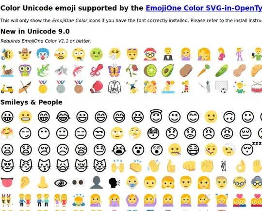

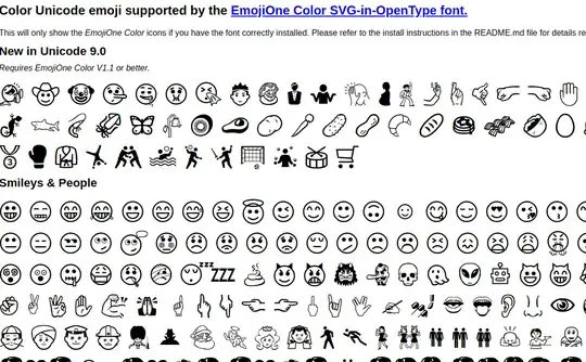

Screenshots from the emoji demo page at http://eosrei.github.io/emojione-color-font/full-demo.html :
Chrome: enter image description here
Firefox: enter image description here
