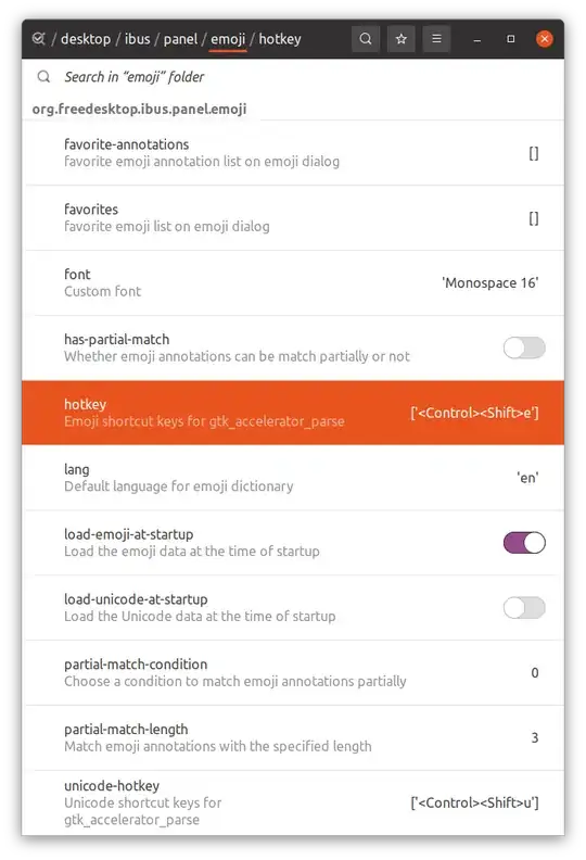

However, when I try pressing Ctrl-Shift-E in Ubuntu 20.10 (e. g. in gedit or Firefox), nothing happens. I still see the shortcut showing up when running ibus-setup:
ibus-setup window
and in the dconf editor:
dconf-editor window
Was the keyboard shortcut for the “Emoji Choice” popup removed? And how can I get it working again?
