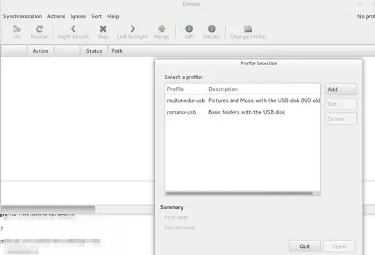

  2. Then I check that the thing works ok using the graphical interface unison-gtk --- from there you can check if the operation is going to be ok): unison-gtk
