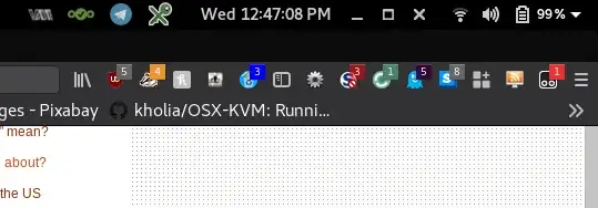

Try this, it solved my problem. This is how Firefox looks after I installed it:
enter image description here The close/minimize/maximize buttons are near (on the right of) the power icon (top right of the screen, they only show when you move the cursor there But you can modify that on Tweak Tools >Extensions >No Title Bar after you install it).
