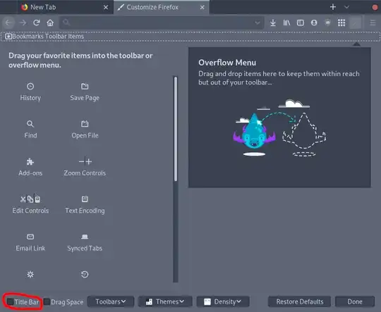

As of September 2019, this functionality is built into Firefox:
  1. Right click empty space on the tab bar
  2. Select "Customize..."
  3. At the bottom of the window there is a "Title Bar" checkbox. Uncheck it to hide the title bar.

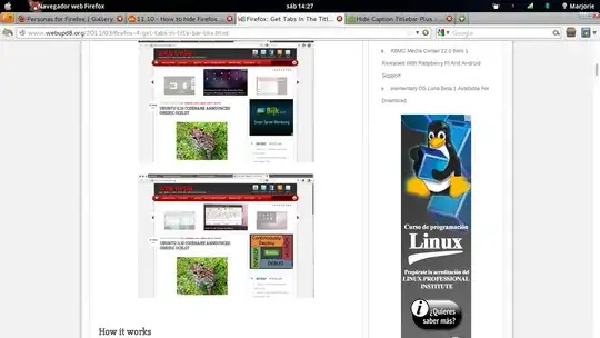

I found a solution: Install this extension: https://addons.mozilla.org/en/firefox/addon/hide-caption-titlebar-plus-sma/
  • It'll show that is not compatible with our version, still click Add to Firefox and install.
All credits to WebUpd8: http://www.webupd8.org/2011/03/firefox-4-get-tabs-in-title-bar-like.html

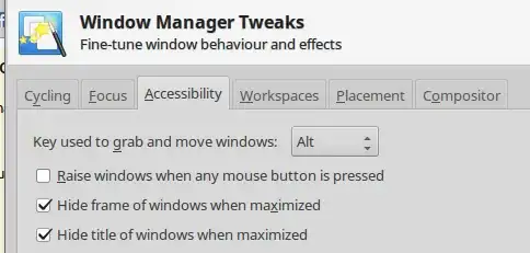

Settings -> Window Manager Tweaks -> Accessibility -> Check "Hide title of windows when maximized"
