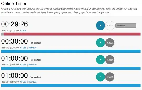

I'm looking for an app to organize my daily tasks in different countdown timers similar to the one found at www.timeanddate.com/timer/
Features I'm looking for would be:
  • runs in terminal bash or zsh
  • multiple independent countdown timers
  • plays a sound or notification display once a timer runs out
Please note that timetracking is not an important feature, just the countdown is enough.
Thank you.
