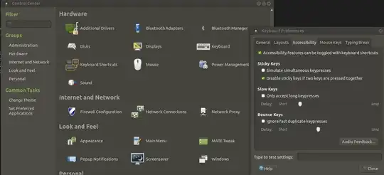

For those with Ubuntu 18.04 who can not find settings -> universal tools Here is what you do simply: Control Center -> Keyboard Uncheck the
Only accept long keypresses
under the
Slow Keys
option
