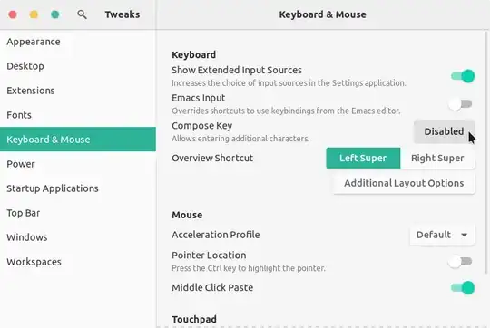

You may use (GNOME) Tweaks to set the option.
First install Tweaks by running
sudo apt install gnome-tweaks
(or sudo apt install gnome-tweak-tool).
Alternatively, for those who prefer the GUI:
  1. launch the Ubuntu Software application.
  2. search for "gnome tweaks".
  3. install.

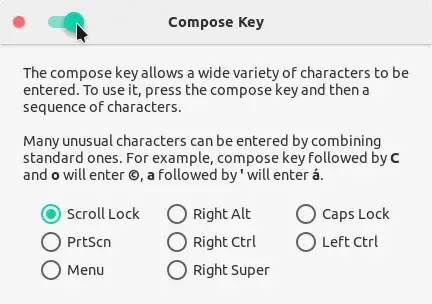

Then launch Tweaks and go to "Keyboard & Mouse" section. The "Compose Key" options is disabled by default. Click on the "Disabled" button.
Then a window will pop up. Toggle the switch at the top on and then you'll be select the compose key
