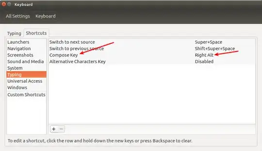

Update For OS: Ubuntu 16.04 x86_64
Alternate characters (like umlauts) are inserted using multiple keystrokes in conjunction with the compose key. In ubuntu 16.04, compose key binding is turned off by default which can be enabled from
System settings-> Keyboard-> Shortcuts tab-> Typing column-> Compose Key
Screenshot
If the value in front of compose key is Disabled, click the value and Press the key to bind from the keyboard. In my case, compose key is set to AltGr key. Now you system to ready to print all german umlauts as below

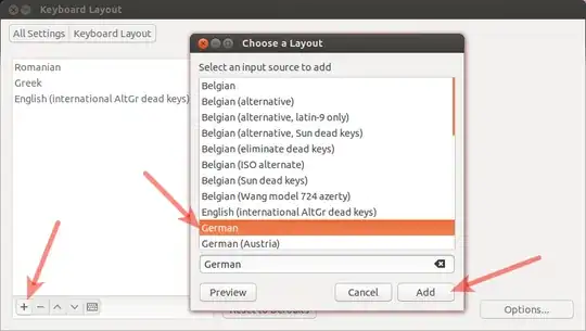

First go in System settings > Personal > Keyboard Layout and add German layout:

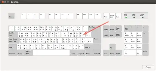

Now, select German layaut and check Layout Chart to see where is 'u with umlaut':
