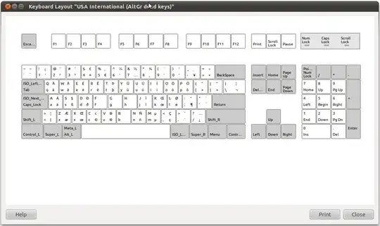

You don't need to use the "US international with dead keys" layout if you're using the compose key. Simply use the standard US layout.
With the "US international with dead keys" layout, you can get some of those special characters without enabling the compose key simply by using the "level 3 select key" (level 3 select key is usually AltGr aka right-Alt key). See the layout:
For example,
  • AltGr+, (comma) gives "ç" and AltGr+Shift+, gives "Ç"
  • AltGr+A gives "á" and AltGr+Shift+A gives "Á"
