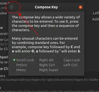

Once Tweaks is installed, run it. Then hit Keyboard & Mouse on the left. In the Keyboard section on the right, an option to enable the compose key can be found. By default it is not enabled, so you will need to click on the word Disabled (confusingly, the word does not look clickable, but it is), which will open another window. Toggle the switch in the top left of that new window's title bar to enable setting the key.
Compose Key window in Ubuntu 20.04
Note that there are still limited options for what key can be set: Scroll Lock, Right Alt, Caps Lock, PrtScn, Right Ctrl, Left Alt, Menu, and Right Super. If you wish to set it to a key not listed, the solution in this answer still works.

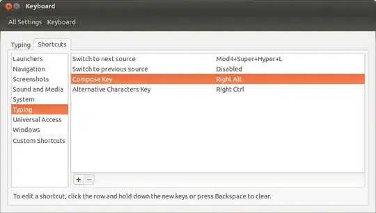

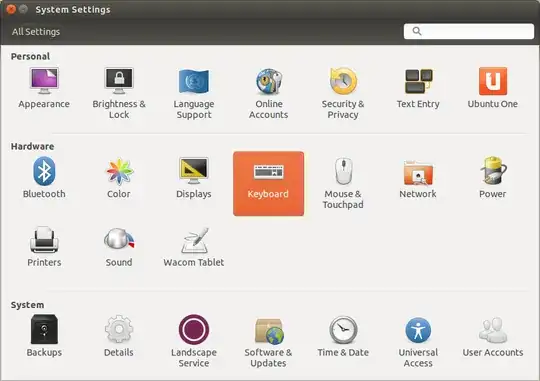

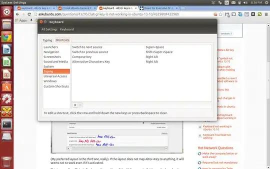

In Ubuntu 13.10
In Keyboard settings window, under Shortcuts -> Typing set Compose key to Right Alt (or other). snap1

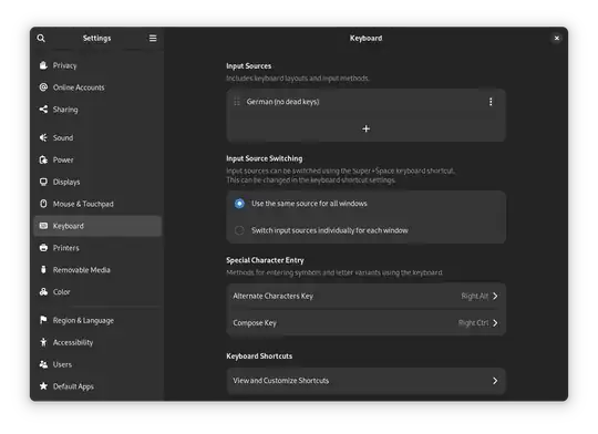

In Ubuntu 22.04 and later:
As of Ubuntu 22.04, gnome-tweak-tools or gnome-tweak can no longer set the Compose key. Instead, you can set it in the Keyboard panel in the Settings application. In the section Special Characters you can activate the compose key.
Keyboard -> Special Character Entry -> Compose Key

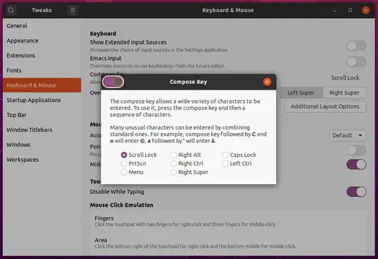

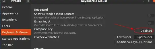

On Ubuntu 19.10, and likely anything using gnome-tweaks (the current name for gnome-tweak-tool), the UI for enabling the compose key is a little confusing. First, under Keyboard & Mouse, click the "Disabled" button:
disabled button
Then this is where the UI is tricky (and utterly indefensible IMHO). Click the switch widget in the top left of the new window:
switch widget
Once you do that, it'll let you actually change the setting.

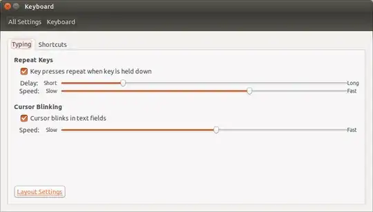

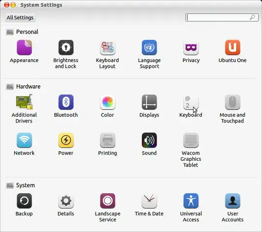

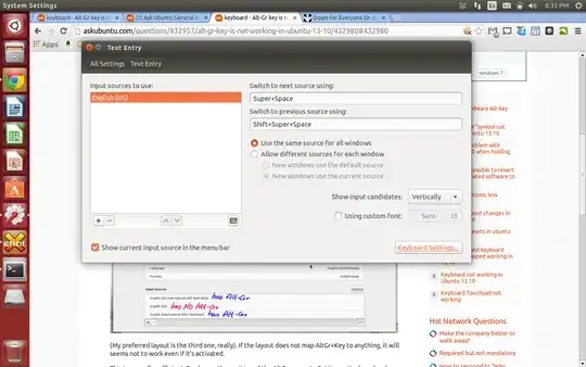

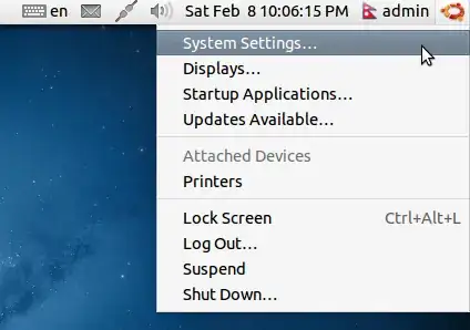

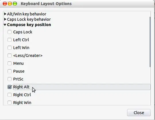

In Ubuntu 12.04 LTS:
  1. Select System Settings... from system menu; snap1
  2. Select Keyboard; snap2

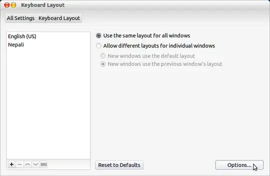

  3. Under the tab labelled Typing click Layout Settings; snap3
  4. In keyboard layout window, click Options... button; snap4
  5. Finally in the Keyboard Layout Options window select Key(s) to change layout and mark the binding of your choice. (I use Shift + CapsLock to toggle the layout.) snap5

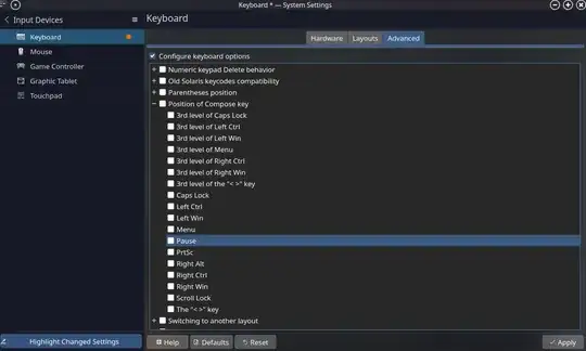

In Plasma 5, go to Settings - Input devices - Keyboard - Advanced - Position of Compose key:
A suggestion: when your keyboard is limited and you lack available keys (as it happens on some laptops) - or when you don't want to use Fn key or to change the default behavior of your keys (like Ctrl), using the 3rd level is very useful (e.g. Altgr+Ctrl).

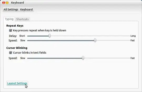

In order to set up the Compose key you must go to (setting -> keyboard -> layout settings -> keyboard settings -> then go to the typing tab -> press and hold the Compose Key setting -> move you mouse down to select the key you want to assign Compose to. enter image description here enter image description here enter image description here enter image description here
