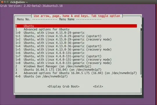

Display Grub Menu Entries from Command Line
I created a script grub-menu.sh to make it easy to find the menu entry number:
Booting with Grub Menu Entry Number
If you wanted to reboot into Kernel 4.4.0-131 you would use:
sudo grub-reboot "1>6"

It seems the kernel you want to boot is in a submenu of grub (just look at the complete grub.cfg). man grub-reboot says:
Please note that menu items in submenus or sub-submenus require specifying the submenu components and then the menu item component. The titles should be separated using the greater-than character (>) with no extra spaces. Depending on your shell some characters including > may need escaping. More information about this is available in the GRUB Manual in the section about the 'default' command.
Maybe something like grub-reboot '2>2' will work for you.
