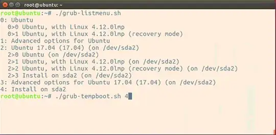

Exactly this has been annoying me for over a year - so I did a quick and dirty script to do it. Hope this helps others?
This stacks the names in a push/pop queue, but not the menu indexing so it could be better but I have gone as far as I could be bothered.
gawk  'BEGIN {
  l=0
  menuindex= 0
  stack[t=0] = 0
function push(x) { stack[t++] = x }
function pop() { if (t > 0) { return stack[--t] } else { return "" }  }
if( $0 ~ /.*menu.*{.*/ )
  push( $0 )
  l++;
} else if( $0 ~ /.*{.*/ )
  push( $0 )
} else if( $0 ~ /.*}.*/ )
  X = pop()
  if( X ~ /.*menu.*{.*/ )
     l--;
     match( X, /^[^'\'']*'\''([^'\'']*)'\''.*$/, arr )
     if( l == 0 )
       print menuindex ": " arr[1]
       menuindex++
       submenu=0
     } else
       print "  " (menuindex-1) ">" submenu " " arr[1]
       submenu++
}' /boot/grub/grub.cfg
Here you can see a screen grab from my box showing it running enter image description here
