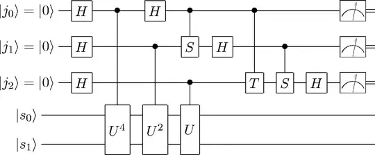

Example
Using the example provided by Hastings:
      A short eigenvalue estimation circuit
Here is how you can compute the circuit depth, adding one gate at a time, to compute the length of the longest path that ends at a given qubit.

  3. Take the maximum of the depths ending at each qubit. In this case, it is qubit 3, with a depth of 8. With a little bit of work, by tracing how this depth arose, you can also find one or more particular paths through the circuit which yields this depth (e.g. H 1 ; CU^4 1 4 5 ; H 1; CS 1 2; H 2; CS 2 3; H 3; Meas 3).

It is the maximum time from input to output assuming all gates take 1 unit of time. So in this example:
Register 3 has 5 gates, but the 2nd gate (controlled-$U$) cannot be done until the controlled-$U^4$ and controlled-$U^2$ are done, so that adds 2 time steps. The controlled-$T$ can be done at the same time as the $H$, so there's no added time steps there. In total we have a gate depth of 7. If you include the measurement as a "gate", then the gate depth is 8.

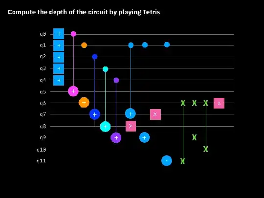

It is hard to beat the animation present in the Qiskit documentation at https://docs.quantum.ibm.com/api/qiskit/0.42/circuit (and in the source tree here) where they describe depth finding as "playing Tetris" and which gives a good intuition about the algorithm:
This suggests the following algorithm:
  • create a linear list of all the gates as they are applied
  • merge gates into the lowest layer as much as possible as long as each gate does not touch a qubit already used up the the layer
  • when a gate arrives that already has one of its qubits used in the top layer, create a new layer and repeat
