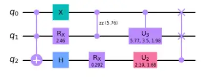

A depth 3 example could be the following circuit:
However, the above circuit would have depth of $1$ after optimization. This is because a CNOT gate followed by another CNOT gate is the same as doing nothing. That is, CNOT $\cdot$ CNOT $\cdot$ CNOT = CNOT. So you don't really need to do an additional two CNOTs.
Another example, consider this other circuit which has depth = 5 (Can you now see why this circuit has a depth of 5? ):

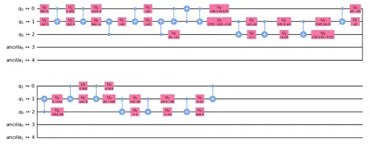

But let's say you want to run it on a quantum computer, and you choose to run it on one of the IBM machine, in particular ibmq_ourense which has the following qubit layout:
Because not all the qubits are connected and not all the gates we've defined in our above circuit are actually native gates of ibmq_ourense, your circuit needs to be transpiled to be run on the real hardware. Fortunately, this can be done automatically with Qiskit. And it is a feature that I believe they are still working to improve upon. So when you submit your depth 5 circuit to be run on the hardware, Qiskit will transpile your circuit to the following circuit:
This circuit has depth 29, instead of depth 5 like the circuit we originally defined.
The point I wanted to make is that the depth of your circuit might change under the optimization and transpilation process so make sure you keep this in mind.
