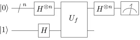

For example, in the Deutsch–Jozsa algorithm,
$\hspace{85px}$,
is the oracle just the box labeled $`` U_f " ,$ or is it everything between the measurement and the inputs (including the Hadamard gates)?
And to give the oracle, do I need to write $U_f$ in matrix form or the condensed form: $U_f$ gives $y \rightarrow y \oplus f(x)$ and $x \rightarrow x$ is enough with respect to the definition of an oracle?

An oracle (at least in this context) is simply an operation that has some property that you don't know, and are trying to find out. The term "black box" is used equivalently, to convey the idea that it's just a box that you can't see inside, and hence you don't know what it's doing. All you know is that you can supply inputs and receive outputs. In the circuit diagram you depict, it is just the $U_f$ box. Everything else is stuff that you are adding in order order to help interrogate the oracle and discover its properties.
To give the oracle, you can write it in any valid form that defines a map from all possible inputs to outputs. This could be a matrix (presumably with an unknown parameter), or it could be the map $U:(x,y)\mapsto (x,y\oplus f(x))$ (strictly, $\forall x,y\in\{0,1\}$), because given either description, you can work out the other.

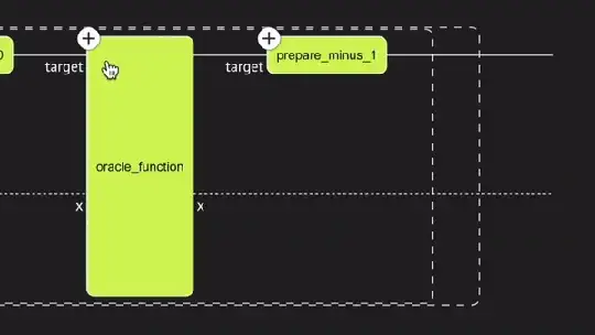

E.g. the following is an oracle written in Classiq's Qmod language (disclaimer - I’m a Classiq employee):
qfunc oracle_function(target: qbit, x: qnum) {
  target ^= x == 0;
this oracle functions applies the oracle for the function $x==0$.
2.How to implement an oracle?
Using high-level functional design tools like Classiq it's quite easy. You design the function you want, and then the compiler synthesizes an underlying implementation. For the above example, this is the underlying circuit implementation for the oracle:
quantum oracle circuit
