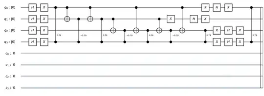

Grover's algorithm circuit may be implemented as follows:
(from here)
It is shown very elegantly by @MartinVesely (How to interpret a 4 qubit quantum circuit as a matrix?) how to translate a 4 qubit circuit into its complete matrix representation.
Building on the previous question, I would like translate the full Grover's ciruit into a single state matrix. I attempted as follows:
Op 1: $H \otimes H \otimes H \otimes H$
Op 2: $X \otimes X \otimes X \otimes X$
Op 3: ?
Op 4: $CNOT \otimes I \otimes I$
Op 5: ?
Does anyone know how to correctly translate operation 3 and operation 5 in particular into its state matrix, please?

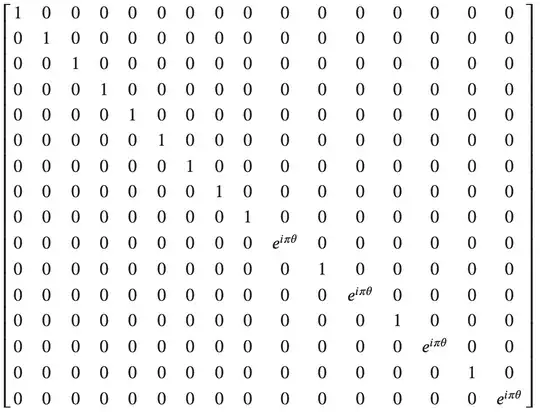

Edit: Similarly to Frank I calculated the unitary (I did the first CU1 gate in the circuit). Wouldn't want to do this by hand.
I did this symbolically with pytket. Note the factor of $\pi$ due to different conventions. $(\lambda = \pi \theta)$
from pytket import Circuit, OpType
from pytket.utils import circuit_to_symbolic_unitary
from sympy import Symbol
theta = Symbol("theta") #theta = 1 / 4 in your example circ = Circuit(4).add_gate(OpType.CU1, [theta], [0, 3]) circuit_to_symbolic_unitary(circ)
