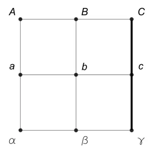

Peres-Mermin in terms of Inequalities
The PM square generates an inequality that is particularly tricky and highly nontrivial so this is the reason why it is so complicated to understand how it can relate to operational distributions. However the problem is not really on the formulation of the probabilities, and in writing the inequality. The problem is to be careful with the experimental implementations. If you simply follow the beggining of this review on quantum contextuality, the notation for the PM square is the following: Consider the following scenario, you have nine dichotomic measurements $\{A,B,C,a,b,c,\alpha,\beta,\gamma\}$ and you have they can be put in a way that they form a table with each row and each columns forming a measurement context. $$\left[\begin{matrix} A & B & C \\ a & b & c \\ \alpha & \beta & \gamma \end{matrix}\right]$$ Given that we know that the measurements are dichotomic, and that what we are really interested is in the compatibility relations of those procedures, we can encode this information in a graph (this is way we have graph-approaches to contextuality, because all the compatibility information relevant for contextuality of measurement procedures can be encoded in graph-theoretic structures). The picture below has the graph, and each row/column line depicts a (hyper)edge defining the context of the measurement procedures.
Since we have dichotomic measurements with outcomes in $\{+1,-1\}$ each conditional probability for the contexts jointly measured can be written as $$\langle C \rangle = p(C = +1) - p(C = -1)$$ for each context $C$ in the set of all contexts $\mathcal{C} = \{ABC,abc,\alpha\beta\gamma,Aa\alpha,Bb\beta,Cc\gamma\}$ and therefore one can find the following operational inequality,
$$\langle ABC \rangle + \langle abc \rangle + \langle \alpha\beta\gamma \rangle + \langle Aa\alpha \rangle + \langle Bb\beta \rangle - \langle Cc\gamma \rangle \leq 4$$ And the quantum realization that is very well known,
$$\left[\begin{matrix} A & B & C \\ a & b & c \\ \alpha & \beta & \gamma \end{matrix}\right] = \left[\begin{matrix} Z\otimes I & I\otimes Z & Z\otimes Z \\ I\otimes X & X\otimes I & X\otimes X \\ Z\otimes X & X\otimes Z & Y\otimes Y \end{matrix}\right]$$
Reaches the value $6$. Note that $p(C=+1)$ encodes the probability distributions $p(C = +1) = \sum_{a_1a_2a_3=+1} p(a_1a_2a_3\vert x_1x_2x_3)$ and therefore the inequality discussed is in the form you wanted; the sum is over all products of outcomes that are equal to $+1$ such as $a_1=-1,a_2=-1,a_3=+1$. Note also that this state-independent proof of the KS theorem is also the largest possible value the inequality can take, which is associated to the fact these proofs are also strongly contextual empirical models.
To obtain the inequality you may consider all deterministic valuations that are vertices of the convex polytope of classical assignments. This vector will be something like $(v(A),v(B),\dots, v(\gamma), v(ABC), \dots, v(\alpha\beta\gamma))$ and there will be $2^9$ possible vectors of this form satisfying the constraint that $v(ABC) = v(A)v(B)v(C)$. With the $V$-representation of this polytope you can find the $H$-representation using standard convex optimization techniques. Here is a program that does that. Important disclaimer: there might be more terms in the construction of these vectors, like terms of the form $v(Aa)$, I am not sure since I haven't do the calculations myself for this particular case, but I think you got the idea, in case I learn properly about this I shall edit this question. What is relevant nevertheless is that the values $v(Aa\alpha) = v(A)v(a)v(\alpha)$ and $v(ABC) = v(A)v(B)v(C)$ with the same value $v(A)$ supposed to be independent on the measuring context considered (measurement noncontextuality, if we would have measurement contextuality then $v(A)$ would need a new label $C$ saying the context of the value assignment $v(A\vert C)$). The original paper that proposed the inequality just presented is the following one: Ref3!
