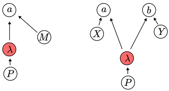

Any prepare-and-measure experiment has an operational-probabilistic structure that is causal in the sense that there is first a preparation step where $P$ is a set of preparation procedures to be performed preparing some system followed by a set of measurement procedures $M$ that return outcomes $A$, in general. Any ontological explanation for this causal operational description will preserve this structure that can be putted in a DAG as follows (see the left DAG on the figure); preparations $P_i \in P$ prepare an ontic state $\lambda \in \Lambda$ describing all relevant degrees of freedom (aka states of affairs, even possible hidden, hance hidden-variables) associated with the preparation stage of a given system. This happens at the very least with some probability $p(\lambda \vert P_i)$, since the preparation could at best be explained in the model as a sampling operation over $\Lambda$ (this is why we normally refer to this as the epistemic states associated with the preparation, since they only describe some possible knowledge of the preparation over the true real states of the system). At the measurement stage we are operating over $\lambda$ that describes for each given measurement in $M_j \in M$ some probability that we obtain the outcomes $a \in A$, denoted as $p(a\vert M_j,\lambda)$ and properly normalized. The success of the OM explaining the probabilities $\{p(a\vert M_j, P_i)\}_{i,j,a}$ is given by the relation, $$p(a\vert M_j,P_i) = \sum_{\lambda \in \Lambda}p(\lambda \vert P_i)p(a\vert M_j,\lambda)$$
To describe contextuality or not of some probabilistic data-table we must define what is an experimental scenario. Since Kochen-Specker noncontextuality does not treat preparations we mostly ignore $P$ and simply write $p(\lambda \vert P) \equiv p(\lambda)$ as the probability that the variable $\lambda$ is being sampled from $\Lambda$. So we would simply write,
$$p(a\vert M_j) = \sum_{\lambda \in \Lambda}p(\lambda)p(a\vert M_j,\lambda)$$ and this is already very close to what I think you want. Note that $M_j$ can be actually a joint measurement and $a$ can be the set of outcomes for those. This is important because in particular for testing contextuality we want to see what happens in a statistics generated by measuring different observables w.r.t. different contexts. I therefore now proceed to define those, and in the following I will show how Bell scenarios appear as an example of these more general scenarios used to study contextuality (that does not need the assumption of many party systems for instance; one could test contextuality in a single chip or a single processor in a quantum computer).

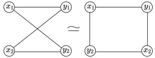

So, already you may have noticed that statistics arising from Bell scenarios allow for this description. Both Bell scenarios are a particular case of compatibility scenarios and the nonsignaling condition is a particular case of the nondisturbing condition. Let us see the particular case for the CHSH scenario where Alice has two binary outcome measurements $\{x_1,x_2\}$ and Bob has two binary outcome measurements $\{y_1,y_2\}$ with the set of outcomes being $\{+1,-1\}$. In this case we have that the contexts are imposed by space-like separation hence we have the structure of contexts as $\mathcal{C} := \{\{x_1,y_1\},\{x_1,y_2\},\{x_2,y_1\},\{x_2,y_2\}\}$. Note that this structure may be putted in a graph (known as the compatibility graph)
Now notice that the statistics arising from such scenario has the structure of a statistics arising from a Bell scenario $\{p(ab\vert xy)\}_{a,b,x,y}$ with in the particular case of the CHSH we have $a,b \in \{+1,-1\}$ and $x \in \{x_1,x_2\}$ the same for the $y$. I hope that by now I have successfully showed you that this is just an example of the following structural result: compatibility scenarios that are used to study contextuality has, as special examples Bell scenarios. Now, in any Bell experiment we must have non-signaling. If we look at the non-disturbing condition for the contexts and apply for the example I am describing we have the following must hold,

This factorization condition implies that whenever we consider the subset of compatibility scenarios to be that of Bell scenarios we have that the equation you wanted arises. For instance, in the case of the CHSH scenario that I used as an example we have that for the contexts $p(ab\vert xy,\lambda) = p(a\vert x,\lambda)p(b\vert y,\lambda)$, which sets the model exactly as the one you have depicted in your question. Finally, I think that this answers your question in the following way:
