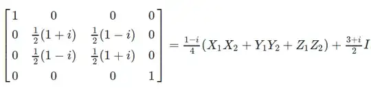

For example, here is a 2-qubit gate (the square root of the SWAP gate) written as a polynomial of Pauli matrices:
