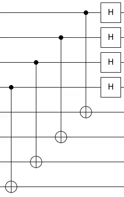

The funny thing is that this fancy looking transformation of the matrix actually corresponds to a very familiar quantum circuit. Flattening the matrix into vector, what's happening is equivalent to applying the CNOT-and-H prefix of a bunch of bell basis measurements! So basically you convert from matrix to Pauli terms by Bell basis measurement.
