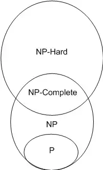

I've found this Venn Diagram to be incredibly helpful in understanding the differences between P, NP, NP-Complete, and NP-Hard.
Venn Diagram
You're right that Traveling Salesman would not be considered NP-Complete. It's NP-Hard, but not in NP. The only way to verify a solution to Traveling Salesman (that we know of today) is to compare it to the optimal solution... and to get that optimal solution, you'd need to solve the problem. There are a whole bunch of NP-Hard problems that are too hard to be NP, including spin-glass.
