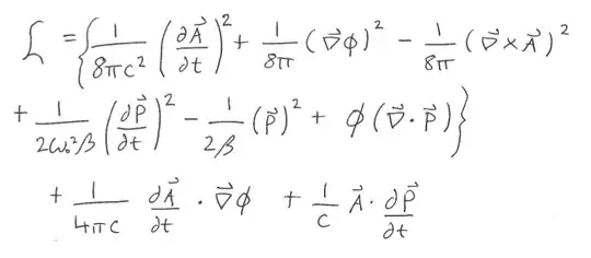

Given the Lagrangian density

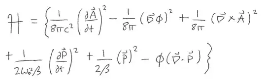

I have derived (several times to check for errors) using a Legendre transformation, the Hamiltonian density:
which is basically the Lagrangian density with a few sign flips apart from that it is missing the two terms outside the brackets in the Lagrangian density $\frac{1}{4\pi c}\frac{\partial\vec{A}}{\partial t}\cdot \nabla\phi + \frac{1}{c}\vec{A}\cdot\frac{\partial \vec{P}}{\partial t}$.
This worries me, as naively I expected to obtain a Hamiltonian very similar looking to the Lagrangian with all the same terms but some of the signs flipped. However I noticed that the 'missing' terms are the only ones which contain non-squared time derivatives so thought that might have something to do with it.

III) Technically, what OP writes in his second equation is not the Hamiltonian density ${\cal H}$ but the Lagrangian energy density function
$$ \tag{6} {\cal h}(A_{\mu},\dot{\bf A},{\bf P},\dot{\bf P}) ~:=~\dot{A}_{\mu} \frac{\partial {\cal L}}{\partial \dot{A}_{\mu}} + \dot{\bf P}\cdot \frac{\partial {\cal L}}{\partial \dot{\bf P}}-{\cal L}.$$
IV) More generally, the point is that the Lagrangian energy function $h$ depends on velocities $v$, while the Hamiltonian $H$ depends on momenta $p$. If the Lagrangian is of the form
$$ \tag{7} L~=~\sum_{n=0}^{2}L_n,$$
where $L_n$ is homogeneous in velocities $v$ with weight $n$ (i.e. the Lagrangian (7) depends on the velocities up to quadratic order), then the Lagrangian energy function is
$$\tag{8} h~:=~~\left(v^i\frac{\partial}{\partial v^i}-1\right) L ~=~\sum_{n=0}^{2}(n-1)L_n ~=~ L_2 - L_0. $$
In words: The quadratic terms $L_2$ are preserved, the linear terms $L_1$ disappear, and the constant terms $L_0$ flip signs.
