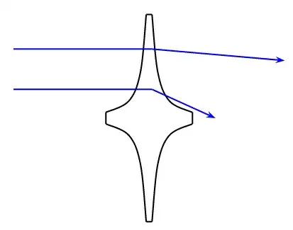

Yes, it's not only possible but relatively easy. For a gravitational lens the deflection angle at a distance $r$ from the black hole is approximately proportional to $1/r$. So your lens is going to look something like a hyperboloid of revolution:
Note that the light rays are bent increasingly strongly as you approach the axis.
This type of lens has been made and a Google will find you many examples. See for example this gravitational lens simulator.
