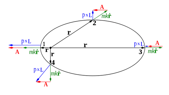

The Runge-Lenz vector also has a rich geometrical interpretation. For a classical elliptical orbit, it points from the focus to the periapsis and its magnitude is proportional to the orbit's eccentricity. For circular orbits, it vanishes.
Image source: Wikipedia

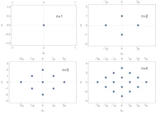

The values of $m$ have been added to the table to make it more obvious that they, together with the eigenvalues $A_z$ and $n$, actually complete the CSCO. We can even plot configurations of the possible states using these quantum numbers, and see a pattern:
possible states with different n
Looking at these plots, we can guess what the eigenvalues of $\hat A_z$ will be for the higher $n$. And then we won't even need the procedure of minimization of variance of the sample of $(3)$ to find the weights $\alpha_l$: we can simply solve this equation with a random sample of points in the domain, setting one of the weights to $1$, and those corresponding to the $m$ we're not interested in, to $0$ (number of points should be chosen to make number of equations equal to number of weights remaining unknown).
Now, $k$th value for $A_z$ appears to follow this formula:
$$A_z(n,m,k)=\frac{|m|-n-1+2k}n,\tag4$$ where
$$k=1,2,\dots,n-|m|.\tag5$$

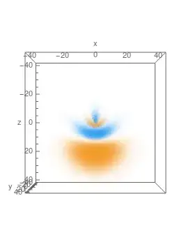

$n=4,\,A_z=\frac34,\,m=0:$
n=4,A_z=3/4,m=0, 3D plotn=4,A_z=3/4,m=0, xz section

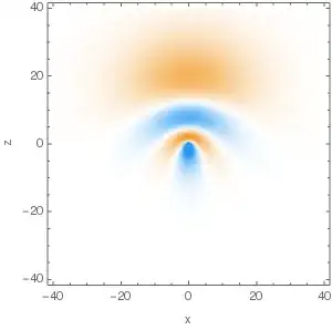

$n=4,\,A_z=-\frac14,\,m=0:$
n=4,A_z=-1/4,m=0, 3D plotn=4,A_z=-1/4,m=0, xz section

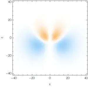

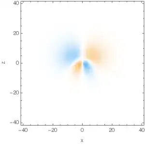

$n=4,\,A_z=-\frac14,\,m=2$, real part:
n=4,A_z=-1/4,m=2 real part, 3D plotn=4,A_z=-1/4,m=2 real part, xz section

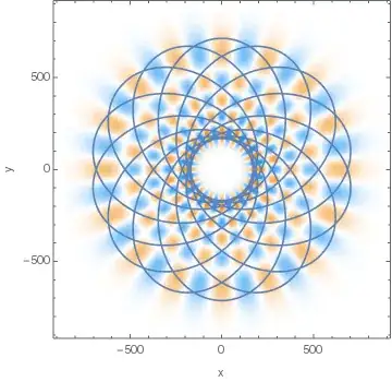

xy cross-sections of real parts of wavefunctions for n=21 and different m=l with classical elliptical orbits superimposed on them
Since these states don't actually have any orientation of the LRL vector (aside from avoiding $z$ direction in case of high $m$ values), a better interpretation and drawing of classical eccentricity for them would be like this:
xy cross-section of real part of n=21, l=m=16 with a set of classical ellipses superimposed on it
where the ellipses show some of the possible orbits one may get if e.g. one were to form a localized wave packet from similar states with this state being dominant.

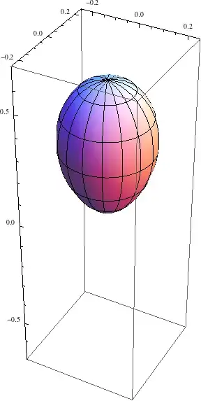

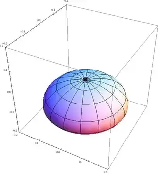

This produces the following plot for the probability distribution in the state $|1,1;1,-1\rangle$:
Plot of |1,1;1,-1>
