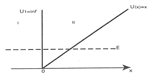

Specifically, my question is: Should one expect energy quantization for a particle in the following potential well? potential
More generally, how can one tell whether or not energy should be discrete/quantized just by looking at the potential function?

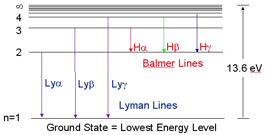

The rule of thumb for me is how would the solutions of the Schrodinger equation look for this potential. When the energy of the electron is above the potential well the solutions can be continuous ( although there can be discrete resonances with an energy width). Below the lip of the potential, as for example in the hydrogen atom, the solutions will be discrete, quantized.
If the walls of the potential go to infinity, as in your example, then all the solutions will be quantized as in this example of the particle in a box .
In the limited in energy potential ( not going to infinity) the energy levels with large energy quantum numbers are very dense and resemble a continuum, although they can be labeled with a discrete number, as for example in the hydrogen atom.
hydrogenatom
Above the energy of the well are the continuum solutions, not discrete.

A summarised derivation for the 1 D triangular potential well can be found here. Interesting graphs of the wave functions $\psi_n(x)$ are provided.
Also treated at [this *.pdf] (p.5, section 1.2.8.2)2.
