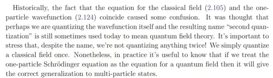

Many modern texts point out that second quantization is actually bad terminology that is kept only for historical reason. For example, both Altland & Simons' Condensed Matter Field Theory and David Tong's Lecture Notes on QFT explained that we are never quantizing anything twice, and second quantization is quantizing a classical field once and only once.
Excerpt from Altland & Simons
Excerpt from Tong

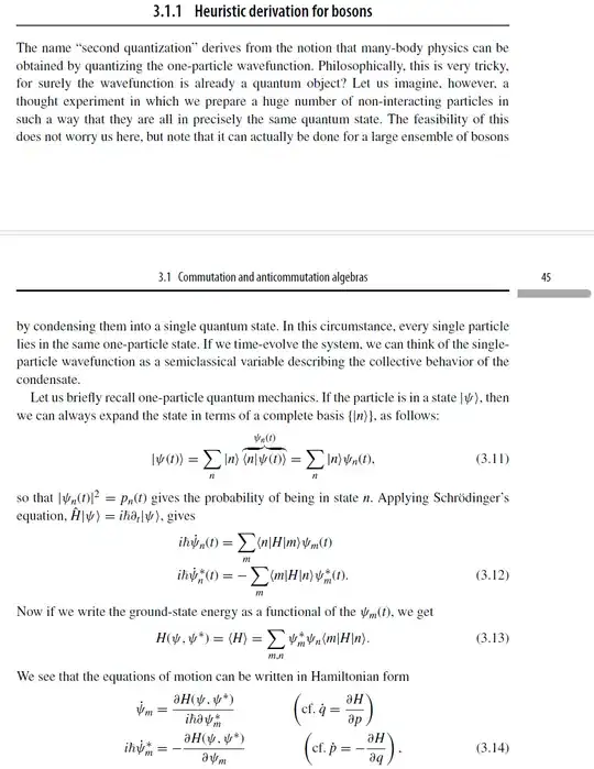

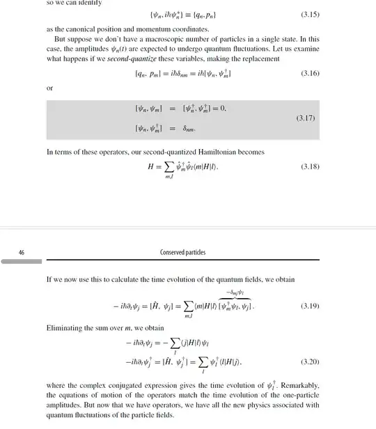

On the other hand, Coleman's Introduction to Many-body Physics gave a hestusic derivation of second quantization by considering the wave function of a Bose-Einstein condesnsate, dervied from it a Hamilton-like equation hence the second quantizated Hamiltonian, and "second quantized" the condensate wave function to a field operator.
Excerpt from Coleman

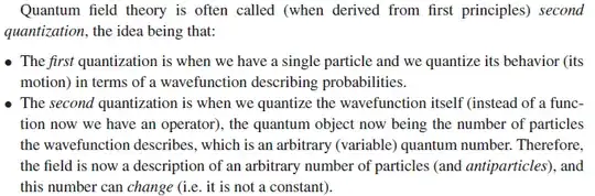

A similar argument could be found in Mahan's Many-Particle Physics. And then, Nastase's Introduction to Quantum Field Theory (which is quite a modern book) claims directly second quantization is quantizing the wave function.
Excerpt from Nastase
