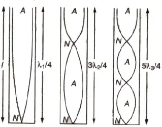

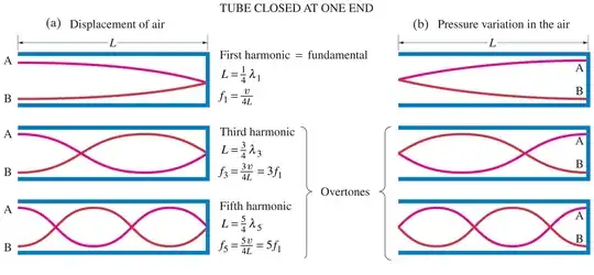

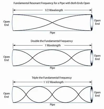

A standing wave in a string ca be viewed as a superposition of the wave reflected by the points where the string is clamped: we pluck the string, the waves propagate towards the ends of the spring, get reflected and interfere with the already existing vibration. Those that interfere constructively survive and give us the tone - the length of these surviving waves is an integer fraction of the string length.
Same happens with the pressure wave in a pipe: it is (partially) reflected at the opening of the pipe, and the reflected wave interfering with the pressure oscillations gives the tone.
The figure below is taken from another SE post, which is worth consulting for more details:
Here is another related thread:
Note the difference with a guitar: the reflection does not necessarily correspond to a node: it is different at the closed and the open ends of the pipe (yet another Physics SE thread):
