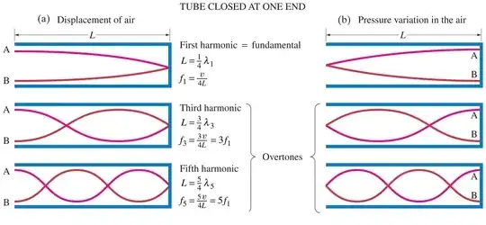

What is the physical reason why there must be pressure waves nodes at the open end of a tube (as in picture (b))?

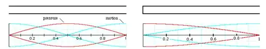

As you cited, the pressure at the open end must be equal to the pressure of ambient air outside the pipe: this is just a boundary condition (I'll come back to this later, but a simple way to understand it is: if we didn't satisfy continuity of pressure, we'd have an infinite pressure gradient and so infinite force). However, for an open end, air can flow freely in and out: that is, the displacement wave does exit and propagate. This diagram shows what happens in an open (left) vs closed pipe (right) of the same length:
The red line is the amplitude of the variation in pressure, whereas the blue line is the amplitude of the variation in the flow of air. As you can see, the amplitude of the displacement wave is a maximum at the open end.

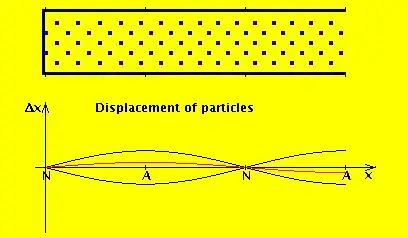

As your animation indicates, maximum displacement occur at the open end. That's at odds with your assertion that the open end is a node. I think the open end is an antinode, similarly, the ends of an open-open tube are antinodes.
