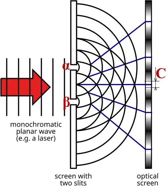

In the double-slit experiment, the slits are labeled α and β. A region C is designated on the screen. The power passes through the open slit: ${P_\alpha} = {P_\beta} = {P_{\rm{sl}}}$
Experiment #1: Both slits are open, and the screen is a flat solid surface. This is well described and shown in the diagram (which is taken from here). The total power of light on the screen is ${P_{\rm{scr 1}}} = {P_\alpha} + {P_\beta} = 2 \cdot {P_{\rm{sl}}}$. The power of light outside the region C is ${P_{{\rm{scr}} - {\rm{C }}1}} = {P_{{\rm{scr }}1}} - {P_{{\rm{C }}1}} = 2 \cdot {P_{{\rm{sl}}}} - {P_{{\rm{C }}1}}$.

Next, the conical pit with A and B is made in the screen within the region C, as shown in the next diagram. The region A sees slit α and does not see slit β. The region B sees slit β and does not see slit α. This means that a straight ray from A falls on α, but not on β. A straight ray from B falls on β, but not on α. Because the angle between A and B is less than the angle between the straight rays from the slit α and β to the screen centre, as shown in the next diagram. Diffraction at the edges of the transition from regions A and B to the flat screen is neglected, assuming the region C size is much larger than the wavelength.
