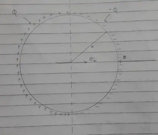

diagram
Note : Extremely Approximated calculations just to check at which scale the effect may be observable
Approximation : Somhow got external field along a single line and all the charges of conductor came to surface equally to two halve rings in the plane of electric field "line" to cancel the external field.
We know that field of a semicircular ring due to charge Q is directed radially away from ring from the centre and has magnitude given by :
Ein = 2kQ/(PI×R^2)
So net electic field due to charges accumulated along ring would be
Ein = 4kQ/(PIxR^2)
Qmax = (total no of electron)×(charge of electron)
Qmax = (moles of metal) × (atomic number) × e
Qmax = (Volume of conductor) × (density) × (avogadro no.) × Z × e / (atomic mass)
Qmax = (4/3 × PI×R^3) × RD × Na × Z × e / M
Emax = (4×k/PI×R^2) × Qmax
Emax = (4×k/PI×R^2) × (4/3 × PI × R^3) × RD × Na × Z × e / M
Emax = (16/3 × 9 × 10^9 × R) × RD × 6.022 × 10^23 × Z × 1.6 × 10^-19 × / M
Emax = (4.6×10^15  × RD × Z/M) × R
for radius in nano scale we will get electric field that would not cause electrical breakdown, on this scale or maybe smaller the effect can be possibly observed. Otherwise the large field would just continue to cause electric breakdowns.
